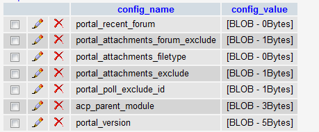

Open your phpmyadmin and take a look at the phpbb_portal_config table. Look for the config_name portal_version and check if it is set to 1.0.5.ReconMarine wrote:Marc

Topic author - Active Member
- Posts: 36
- Joined: 9. December 2009 09:20
- phpBB.com User: ReconMarine
Re: WTF have I done!: Portal is double
How do I see that in the mysql? I mean I see the line, but when I go to edit it, or look at it on a single line, I am not sure if I see the right option.
Can you screenshot that for m, so I know exactly what it should look like?
Thanks bro.
Thanks bro.
Click on the pen in front of portal_version and it should show you the values.
I do not have that line...
I have one that says Portal_Version_Check
But not the other...
![Überrascht :o](./images/smilies/icon_e_surprised.gif)
Did the installer finish correctly after the update? If not, just add that line:
config_name = portal_version
config_value = 1.0.5
