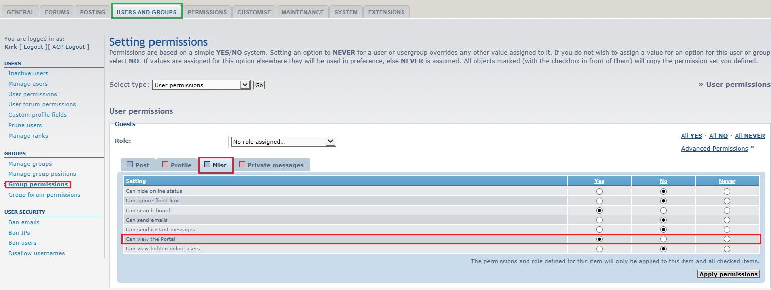

Guests have not permissions "Can view the Portal" Check this.
Condor
Posts: 10
Joined: 11. December 2015 11:41
Re: How to ... Redirect to the portal after login / logout
Post by Condor »
Kirk, you 're really genious !
