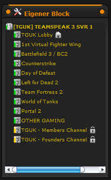

I have added a custom block on the right without a problem though, which also has BB Code turned off.. ( this is below if it helps )
<iframe allowtransparency="true" src="http://www.teamgamers.co.uk/ts3wi/tsviewpub.php?skey=0&port=9987&showicons=left&bgcolor=232323&fontcolor=d0b20b" height="320" width="230" scrolling="AUTO" frameborder="0" marginwidth="0" marginheight="0" name="pa">
Your Browser will not show Iframes</iframe>
I would like to just point out, that all this code above worked perfectly in 1.0.6 Board 3 and also on the beta release of 2.0.0b.
