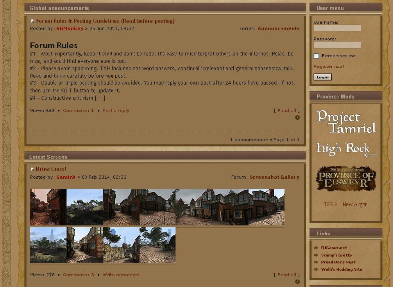

Having some minor issues after making some changes to my forum style. Basically I wanted to adjust the post profile area to be a fixed width.
I followed this quick guide. Which works fine as far as I can tell, everywhere except on the portal.
On the site http://provincecyrodiil.project-tamriel.com/ If you switch to the proCyrodiilWide style you will see the issue.
At first i thought it may be a problem with that style itself. So i tried it on my other forum http://highrock.project-tamriel.com/ and I get the same issue.
I'm sure it's something minor that's causing the issue but I just can't seem to see what it is.
Any help at all would be greatly appreciated. I know I'm using a slightly older version of the portal and I do intend to update it once ive gotten this issue resolved.

Re: Portal issue
The problem is that here:
.postbody {
    color: #0F1415;
    line-height: 1.48em;
    margin: 0 0 0 191px;
    padding: 0;
    width: auto;
Find and delete this :

Post by Mordynak »
Wow... That was quick.
Thanks a lot I really appreciate it!

Mordynak wrote:I don't suppose you know of a way to increase the padding on the left side of the post contents?
Copy this _block_config.html to root/styles/proCyrodiilWide/template/portal
<!-- DEFINE $LR_BLOCK_H_L = '<div class="forabg"><div class="inner"><span class="corners-top"><span></span></span><ul class="topiclist"><li class="header"><li class="header"><dl class="icon"><dt style="width: auto;">' -->
<!-- DEFINE $C_BLOCK_H_L = '<div class="forabg"><div class="inner"><span class="corners-top"><span></span></span><ul class="topiclist"><li class="header"><dl class="icon"><dt>' -->
<!-- DEFINE $CC_BLOCK_H_L = '<div class="forabg"><div class="inner"><span class="corners-top"><span></span></span><ul class="topiclist"><li class="header"><dl class="icon">' -->
So it looks after:

Post by Mordynak »
Apologies for the delay. Adding the block config to the template did fix an issue I had with styling on the portal which is excellent!
However I still have one minor issue left. After making the profile pane a fixed size, the post contents are pushed right up to the edge of the profile information.
