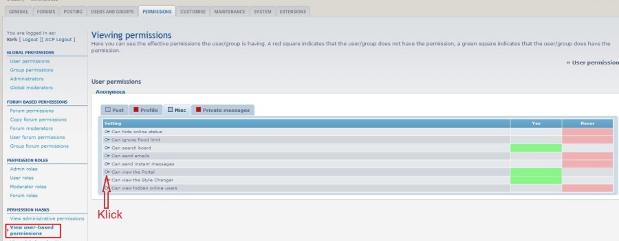

Re: Portal not visible for guests
Go to
Klick on " Select anonymous user", klick "View permissions"
ACP/Permissions/Permission Masks/View user-based permissions
