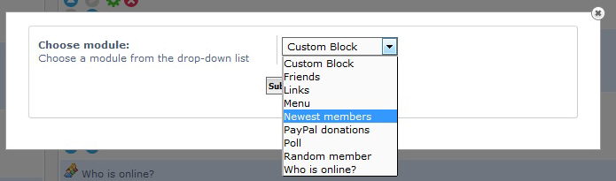

- Dev
- Posts: 1985
- Joined: 27. July 2010 18:02
- phpBB.de User: Kirk
Re: Creat module for board portal 2.1
In the ACP / Extensions / Portal Modules, click the Add module button on the left or right and select the module from the drop-down menu.
