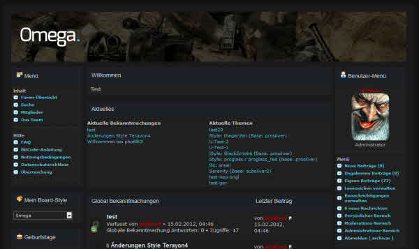

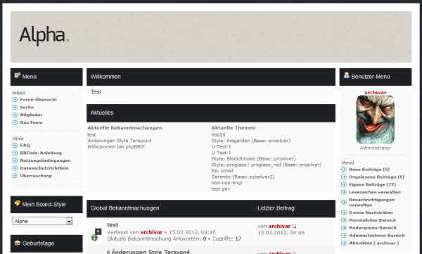

Style Version: 1.0.0
Style Download: https://www.phpbb.com/customise/db/style/alpha/
Screenshot: Style Download: https://www.phpbb.com/customise/db/style/0mega/
- This Guide is written for Styles "Alpha", but it works for Styles "0mega" also.
 If you want to use this Guide for "0mega" you just have to replace "Alpha" with the Name of your Style in this Guide.
 to: root/styles/Alpha/template/portal/*.*
 to: root/styles/Alpha/theme/portal.css
 to: root/styles/Alpha/theme/images/portal/*.*
